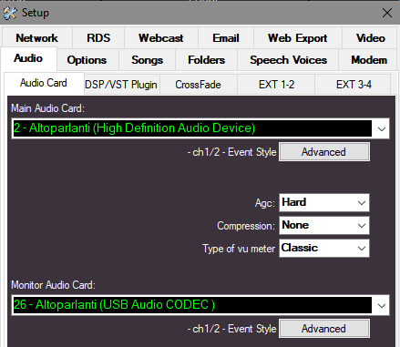

Main Sound Card - This is the playout card of MB STUDIO. Here are listed your audio output devices. If you don't have or don't want to use an audio card set it to "MBStudio Mix" to use the internal mixer.
Advanced - Advanced sound card configuration
Multichannel - Output configuration with multi-channel sound cards
Agc
Automatic Gain Control keep control of the playout level, you can choose between 3 presets: Soft, Standard, Hard. If you are already using a plugin DSP or an external DSP keep this function to None.
Compression
This effect apply a compression to the playout, you can choose between 3 presets: Soft, Standard, Hard. If you are already using a plugin DSP or an external DSP keep this function to None.
Monitor Audio Card
Here you can set a 2nd audio card for monitor (cue).
