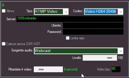

Now in MB STUDIO we configure an RTSP encoder like in this image:
as you can see we send the RTSP stream to the local port :8554 with the name mbradio (you can change it as you wish) and to avoid unauthorized external access I entered a temporary login mbstudio and password mbstream.
After activating the encoder you can access the video with any rtsp player by opening the address rtsp://address:8554/mbradio (or other stream name you have given)

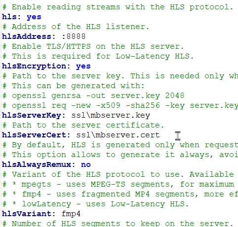

Not only that, the stream is also served directly to browsers from the address http://address:8888/mbradio (or other name flow you gave)  for example my test stream is here: https://mbsoft.net:8888/mbradio/
If you want to connect to the server via the internet you have to open the incoming ports 8554 and 8888 tcp on the router and map them to the computer where the server is located and in this case I recommend changing login and  password: open the mediamtx.yml file with a text editor and edit the lines publishUser: and publishPass: (note that there is an empty space between the 2 dots and the name and pass)
